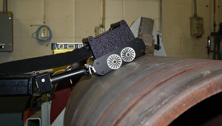

The majority of pipe welds completed in fabrication shops are rolled. Rotating pipe while welding provides many benefits, including ease of achieving quality welds by eliminating out-of-position welding, reduced welder fatigue, and improved productivity from higher wire feed speeds and increased deposition rates. The ProHeat 35 Induction Heating System with Rolling Inductor allows fab shops to preheat work pieces — including moving parts. It delivers fast, consistent heat up to 600 degrees Fahrenheit.
