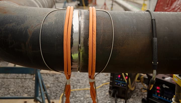

Welding preheat equipment such as air-cooled cables and a new heating tool for induction, deliver flexibility and efficiency.

Most welding preheat applications performed using air-cooled blankets or liquid-cooled cables can use the air-cooled cables from Miller Electric Mfg. LLC. Air-cooled cables eliminate liquid cooling requirements while still providing a flexible and efficient solution for welding preheat.
Operations utilize welding preheat on carbon steel that is heated up to 400 degrees Fahrenheit (204 degrees Celsius). The air-cooled cables, used with the ProHeat™ 35 induction power source, are rated for up to 400 degrees Fahrenheit in the heating zones around the weld, and they can be used with pipe diameters of 3/4 inch and up. The cables have amperage capabilities of 250 amps maximum and 200 amps continuous.
In addition, operators can bend or shape the flexible cables to best fit the pipe, flat plate or part, so they’re a solution that can meet many preheating needs.
