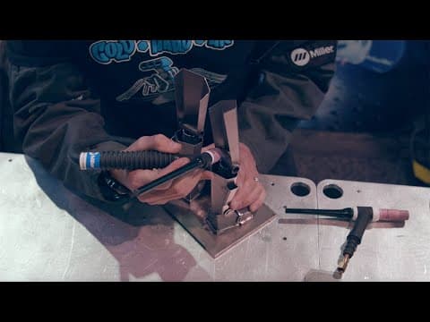

Weldcraft – Understanding Gas Coverage
In GTAW, consumables include a nozzle and a collet paired with either a gas lens or a collet body. Your choice depends on the weld requirements:
Allow proper testing to verify the combinations work for your application and follow the WPS.
A collet body has several holes that introduce the shielding gas inside the nozzle. These holes tend to be perpendicular to the nozzle, causing the gas to spiral or be more turbulent as it exits.
When using a collet body, keep the tungsten extension within the inside diameter of the nozzle.
A gas lens uses multiple screens to create a more uniform laminar flow, improving the consistency of the shielding gas coverage and reducing turbulence compared to a collet body. The gas lens allows the tungsten to extend farther than the inside diameter of a standard collet body.
TIG Torch Tip: Gas Lens vs. Collet Body
The nozzle, also called the cup, screws onto the collet body or gas lens and introduces the gas to the weld. The nozzle plays a critical role in directing shielding gas to the weld, and its size and shape influence gas coverage and overall weld quality.
Nozzles come in standard, long and extra-long versions. Longer nozzles allow the gas flow to develop before exiting, creating smoother laminar flow and improving access to tight joints.
Larger diameters produce longer laminar flow for better shielding.
Smaller diameters are used for tight spaces or smaller parts, but they increase gas velocity, which can lead to turbulence.
