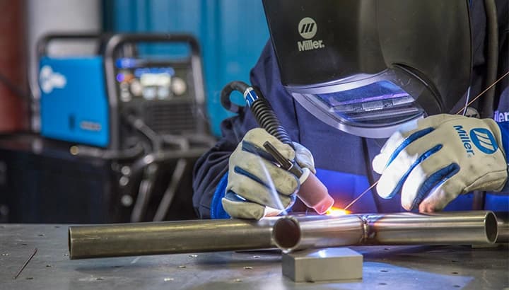

Tip #2: Why is TIG welding best for chromoly?
Chromoly is heat-sensitive, which makes TIG welding the preferred process over MIG. TIG offers better control of heat input, helping prevent brittleness and distortion.
  • A shorter arc length (staying closer to the base material with the tungsten) reduces the total arc energy. This helps keep the heat-affected zone narrower.
  • When the arc length is longer, the machine has to produce more voltage to bridge the gap, which increases the power and heat generated. This in turn makes the heat-affected zone larger, causing the zone to be more brittle.

Tip #4: Why use a gas lens for chromoly TIG welding?
For TIG welding chromoly, choose a gas lens instead of a collet body. A gas lens provides more consistent shielding gas coverage than a standard collet body. It uses several screens that create a uniform laminar flow, reducing turbulence and improving weld quality.
Benefits of a gas lens:
  • Better gas coverage: Prevents shielding gas from rolling off curved surfaces like chromoly tubing.
  • Extended tungsten reach: Allows the tungsten to stick out farther for access to tight areas while maintaining a short arc length.
  • Lower heat input: Helps keep the arc stable and reduces heat-affected zone issues.
For chromoly TIG welding, ceriated (gray) tungsten is a good choice for consistent performance.
