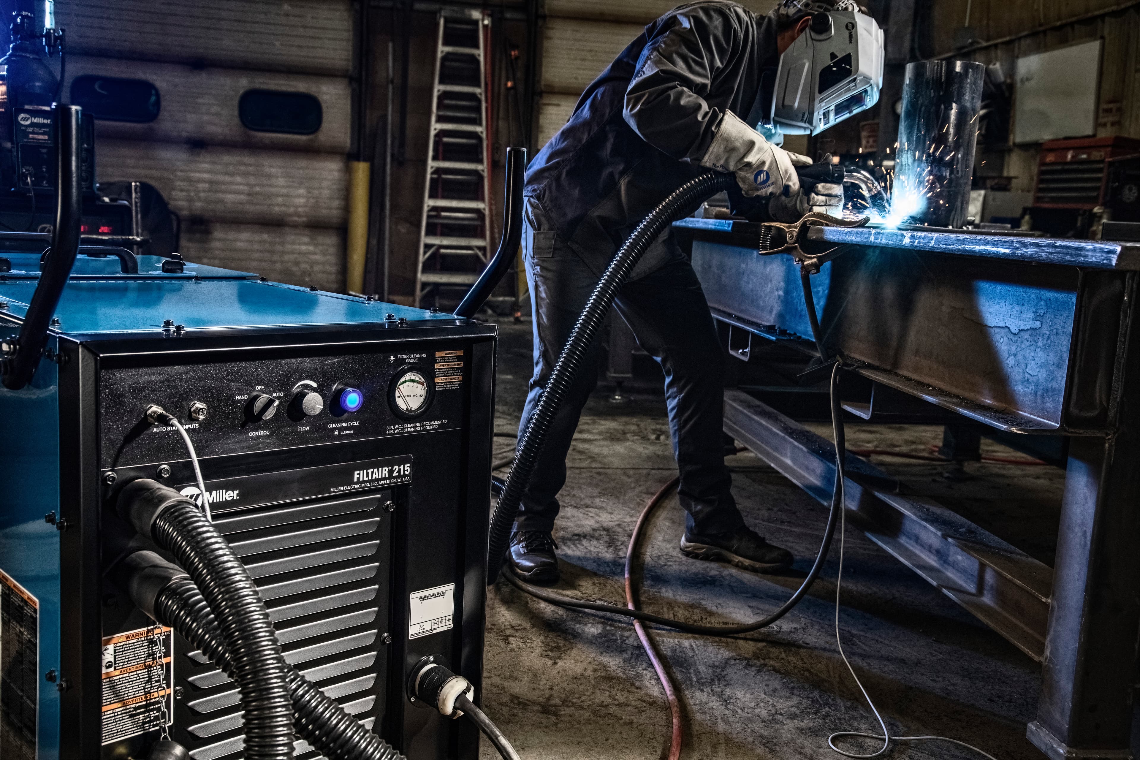

Unique fabrication and manufacturing settings require unique fume capture solutions. The FILTAIR 215 provides high-vacuum fume extraction for up to four operators at a time. The high cfm allows for long hose reach, so it's an effective solution even when placed far away from the welding activity. The FILTAIR 215 is a set-it-and-forget-it-type unit, optimized so you can realize efficiencies in per-operator cost while improving performance.

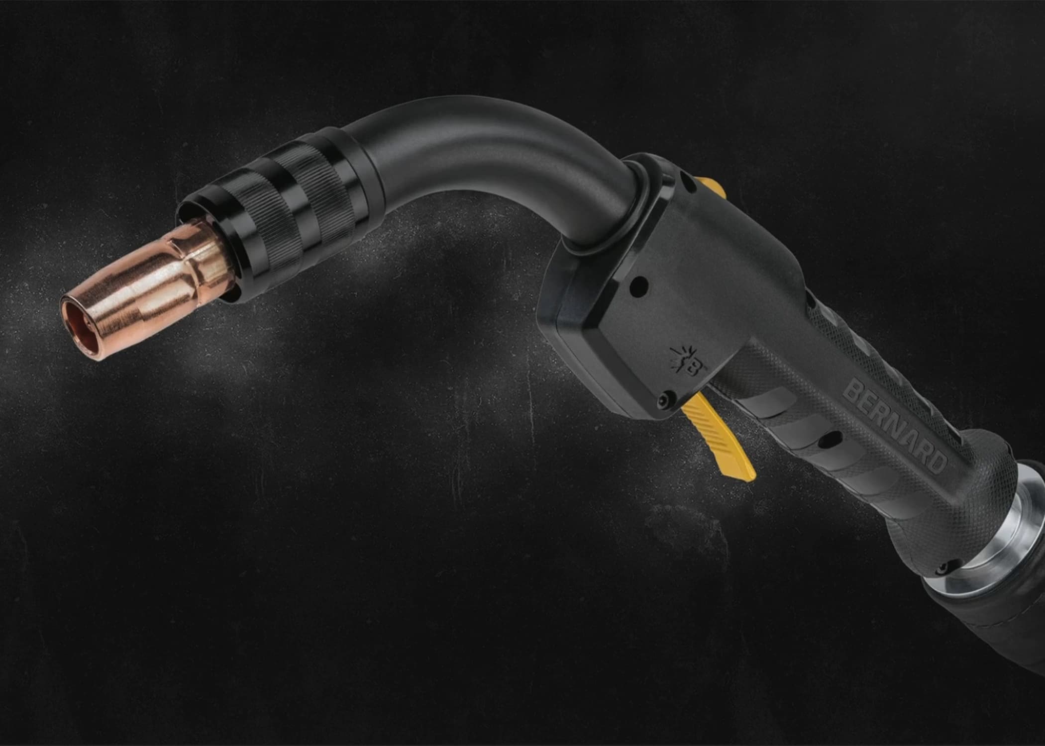

FILTAIR 215 works with any fume gun, including the Bernard® Clean Air E™ fume extraction MIG gun. Capture up to 95% of fumes at the source with this fume extraction gun, designed for use in environments from heavy industrial to truck and trailer manufacturing to fabrication.
