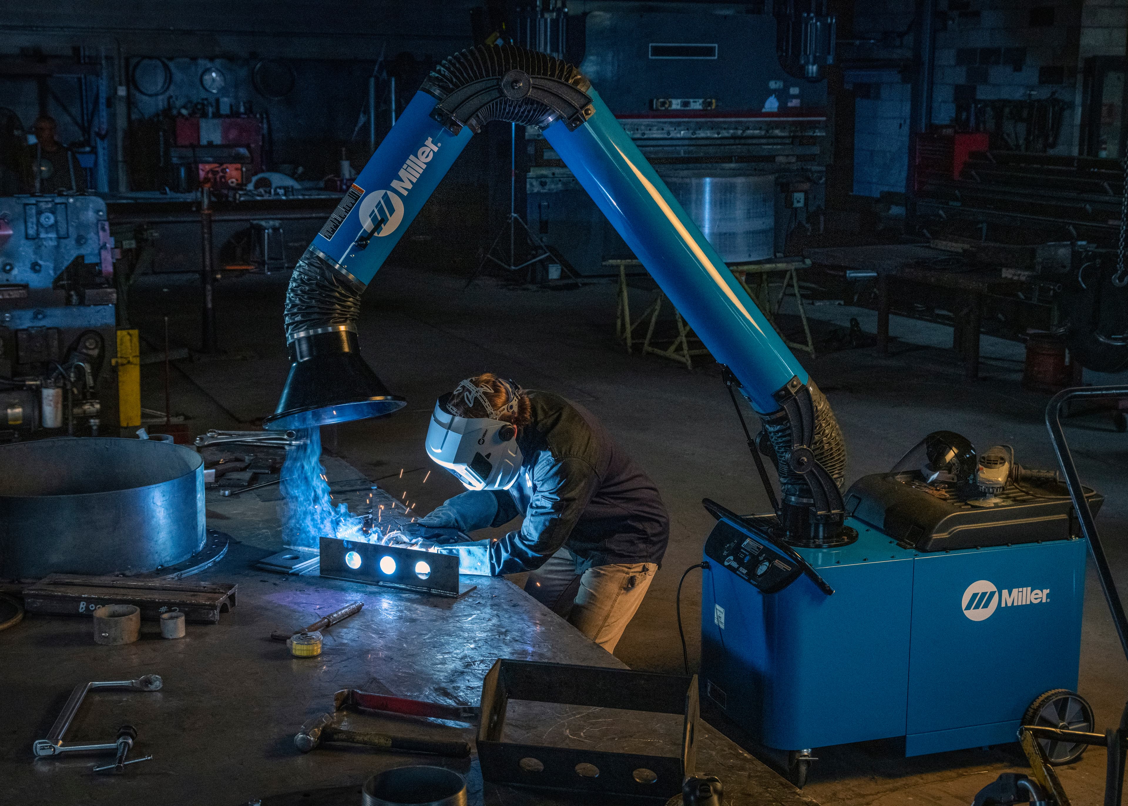

  • Easy-to-Operate Extraction Arm
    With external adjustments so air can pass through with less airflow resistance, giving you stronger CFM (airflow). It offers reliable and accurate positioning across the full range of motion of the arm, as well as easy adjustment and maintenance to ensure long-lasting operation. Pre-assembled extraction arms are available in 7-, 10- and 12-foot lengths.
  • Preassembled Arms
    For fast, easy setup
  • Durable Bellmouth-Shaped Hood
    Features a convenient 360 degree rotation for unlimited positioning. One of the largest in the industry, FILTAIR’s extraction hood captures weld fumes at a greater distance from the source than other hood designs. This also means less hood adjustments for longer welds.
  • MERV 16 Filter Rating
  • Self-Cleaning Mechanism
    The self cleaning mechanism is easy to use. Just push button on control panel to activate the pulse cleaning cycle that cleans the filter from the inside out. Weld fume particulate is removed from the filter and safely deposited in the particulate disposal drawer.
  • Hinged Filter Hatch
    Features a convenient locking mechanism for easy access to the filter and tool-free replacement.
  • Metal Cabinet Design
  • Convenient Air Connection
    For dry compressed air supply. Note: Compressed air required to operate cleaning mechanism.
  • Built-In Tool Tray
    Provides workers with a convenient area to place their tools without them rolling off of the unit.
  • Filter Pressure Gauge
    With easy-to-read color code indicates when pressure drop increases and cartridge filter needs to be replaced (MWX-D) or cleaned (MWX-S).
  • 115 VAC, 20-Foot (6 m) Power Cord
    Enables welders to freely move fume extractor.
  • Large Rear Wheels
    Allow for easy movement over weld cables and from one work cell to another.
  • Lockable Swivel Casters
    Allow users to keep fume extraction system stationary during movement of the arm.
  • Power Switch
    Switch is conveniently located for easy on/off access.
  • Particulate Disposal Bin
    Provides easy and convenient access to empty out collected particulate. Handles release drawer allowing it to slide out.
