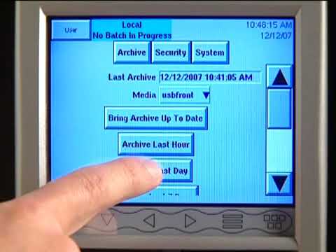

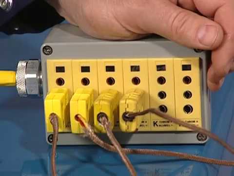

Q: Can I use the recorder to document heating with the Rolling Inductor?
A: Yes. If the Rolling Inductor is used with compatible temperature measurement devices (customer supplied) you can record heating temperatures. Measurements should be taken within two inches of the Rolling Inductor.

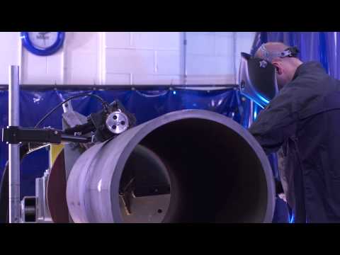

Q: What happens if I run the Rolling Inductor without rolling the pipe or moving the induction head?
A: Depending on output, material type and material thickness, if the Rolling Inductor remains stationary for too long it can overheat the work piece and cause irreversible damage to the work piece and Rolling Inductor. For this reason it is extremely important to ensure that either the work piece or Rolling Inductor is moving at all times. Using the Travel Detect System (301183) helps minimize the chance of overheating a stationary, object by constantly sending feedback to the power source and limiting output if limited or no motion is detected.

Q: Do all four Rolling Inductor wheels need to be in contact with the work piece at all times?
A: Power coupling to the part decreases as the distance to the part increases. Maintaining constant distance between the rolling inductor and the work piece will ensure consistent heating, using the wheels is the best way to maintain a constant distance. The wheels should be the only part to contact the work piece, if any other part of the rolling inductor stays in contact with the work piece damage can occur.
Q: Does it matter which way I roll the pipe/work piece when using the Rolling Inductor?
A: When using the Rolling Inductor always roll away from the power cable. (Clockwise when the cable is exiting left and counterclockwise when the cable is exiting right)
