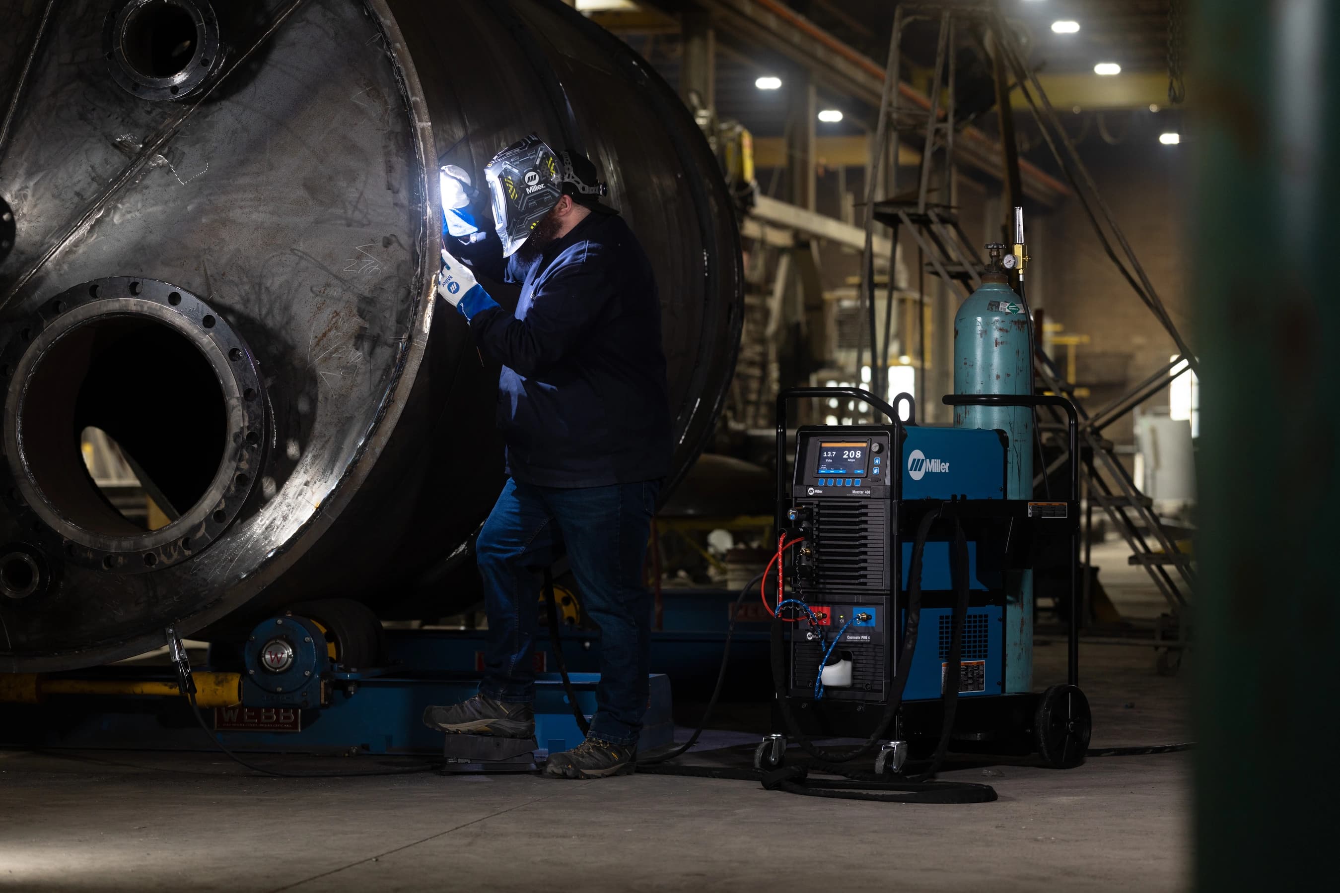

Mistake #1: Excessive Heat Input
Excessive heat input is one of the most common and costly food‑grade welding mistakes. It often shows up during TIG welding when amperage isn’t consistently controlled, travel speed fluctuates or pulse settings aren’t optimized for thin stainless.
Why it matters: Too much heat does more than distort a part. It can actually change the properties of the stainless steel and filler metal, reducing corrosion resistance and accelerating degradation over time. Even if the weld bead looks smooth on the surface, excessive heat can compromise long‑term performance, leading to premature rusting, rework or failed inspections down the line. Heat also increases the likelihood of oversized beads, oxide formation and uneven profiles, all of which can create sanitation risks or require rework.
How to avoid it: This is where precise amperage control and arc stability become critical. TIG power sources designed for stable DC TIG performance and fine low‑amperage control, such as the Miller® Maxstar®, help welders manage heat input more effectively. The pulsed TIG function switches the amperage from a high (peak) to a low (background) at a set rate (PPS). Pulsing can reduce heat input by lowering the average amperage, increasing control of the weld puddle, penetration and distortion.
By maintaining a steady arc and allowing welders to dial in exactly what’s needed, machines like the Maxstar make it easier to preserve material integrity while producing smooth, consistent weld profiles suited for hygienic environments. Ultimately, managing heat input isn’t about welding faster or hotter; it’s about slowing down, staying consistent and using equipment that supports that level of control throughout the weld.
