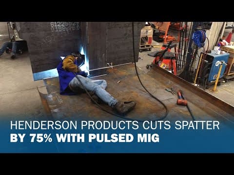

Henderson Products Cuts Spatter by 75% With Pulsed MIG
MYTH 3: Pulsed MIG is slower than traditional MIG.
FACT: Pulsed MIG can provide faster travel speeds — allowing operations to boost productivity — when proper procedures are used.
The belief that pulsed MIG is slower than conventional MIG welding may hold some operations back from making the switch. But pulsed MIG can provide productivity boosts for most applications.
When average weld current is maintained, along with adjustments to arc length and travel speed to maintain similar bead size, pulsed MIG welding typically provides faster travel speeds with lower spatter compared to conventional MIG.
Deltaweld systems from Miller deliver pulsed capabilities in an integrated package and offer Accu-Pulse™ technology, which provides a 28% wider operating window and a more forgiving arc to help speed up your operation.

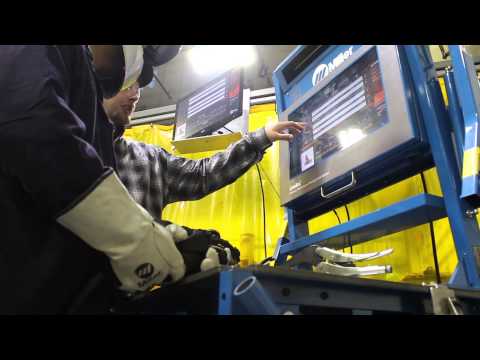

The AugmentedArc® Augmented Reality Welding System from Miller simulates multiple welding processes, blending real-world and computer-generated images into an augmented reality environment. This lets new welders build their muscle memory and learn the basics of welding without using any costly consumables or filler metal.
See how one manufacturer used the Miller LiveArc™ system to train welders.
