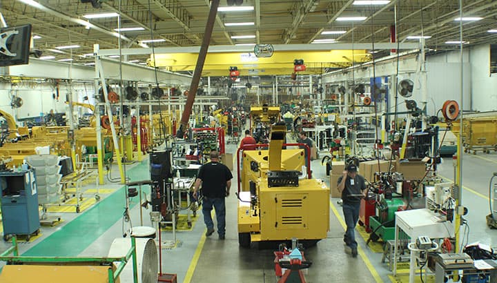

Many companies have digitalized processes upstream and downstream of the welding operation but may hesitate to digitalize the welding itself. They may view welding as too highly specialized to incorporate into the digital integration.
But including welding in this integration is important, because it provides visibility into what’s happening in each weld cell. Evaluating the welding operation is critical when a company wants to improve overall throughput and productivity. Key weld data operations can track includes filler metal used, shielding gas used, electricity used, voltage, arc-on time and part production. Another benefit of digitalizing the welding environment is the ability to create digital documentation, which provides an accurate record of every weld performed on every part produced by the welding operation. This helps companies ensure for customers that they are following the exact parameters and specifications. It can also help operations track issues that may be slowing down production.
Knowing what’s happening in the welding department is valuable for both the upstream and downstream processes. For example, identifying a problem in the welding cell can help pinpoint when it’s better to bring pre-assembled parts into the upstream process, or when to outsource a certain task downstream.
Without digitalization, welders in the cell may be dealing with issues by adjusting parameters. But they may not be reporting these problems so they can be tracked and properly addressed. When operations digitalize weld cell data, they can track and monitor even small issues to help improve productivity and results.
